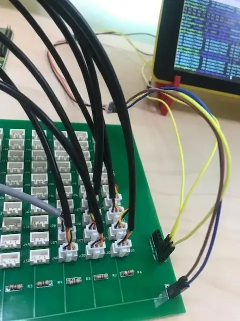

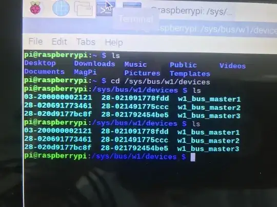

I updated config.txt and opend 4, 17, 27 pins. So now I am using 3 pins. As a first trial, I connected 4, 4, and 2 DS18B20s to 4, 17, and 27 pins, respectively. Interestingly, my RPi can find every sensors in this case. Followings are PCB and Terminal screen.
teminal with 4, 4, 2 connection PCB with 4, 4, 2 connection
Then, I connected 5, 4, 1 DS18B20s to 4, 17, and 27 pins, respectively. In this time, my RPI can detect only 5 sensors which are connected to 17 and 27 pins. Followings are PCB and Terminal screen.
teminal with 5, 4, 1 connection PCB with 5, 4, 1 connection
I am guessing that there is a restriction on the number of DS18B20 on a bus. Am I right?

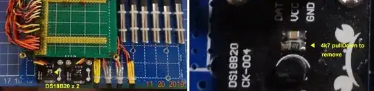

Update 2019nov20hkt1014
ds18b20 pullup

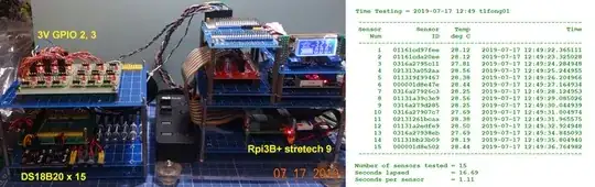

I connected 12 DS18B20 to GPIO2, and another 3 to GPIO3, and found measurements stable. I am using the I2C pins for now. I hope to test other pins after I finished testing Rpi4 and buster.
ds18b20 test

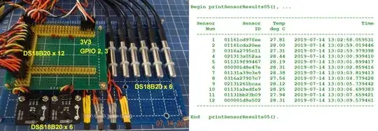

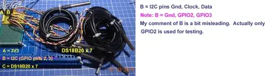

Now I am testing 12 DS18B20 devices, all connected to one GPIO pin 2, configuring as star. Now I am finding that the syatem is not reliable, in that it takes longer to made one measurements, from about 1 second to up ta 1.5 seconds. I need to find if using daisy chain configuration can improve the performance.
Testing 11 sensors OK. All 11 sensors connected in parallel, power 3V3, all output pins connected to GPIO2 (Similarly to shown in the following post . Test program list and sample output shown in Appendix B.
wiring picture

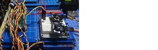

Now I am going to test 9 sensor modules, suing 2 or 3 GPIO pins.

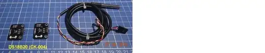

ds18b20 modules

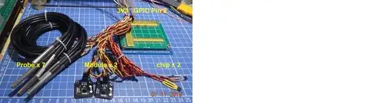

Now I am testing 11 DS18B20 (7 with waterproof probes, two modules, two through hole chips), all on the same bus connected to GPIO2. I found measurements stable. See sample output and program listing in the appendix below.
ds18b20 modules

Setup
setup
I think I confused everybody by using I2C data pin for DS18B20. Actually I can use any other pin. The reason that I choose I2C Data pin (GPIO 2) is that I know I2C CLK and DATA pins have a very strong pull up of 1k8. All other pins (only 90% sure) have pullups of 50k. In other words, I don't need any extra 4k7.
