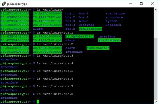

Moreover I noticed, that the virtual /mnt/1wire directory only shows 9 sensors on the first 2 channels, although I'm able to read 11 sensors (on 4 channels) with the Node.js-script without problems. How's that possible???
<code>/mnt/1wire</code> directory shows 9 sensors but with the Node.js-script I'm able to read 11

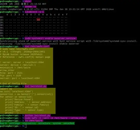

Part 1

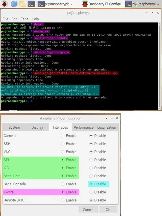

Configuring python owfs (Refs 29, 32)
owfs install config
Part 2 - Testing OWFS Server without any DS18B20 sensor connected.
owfs server test

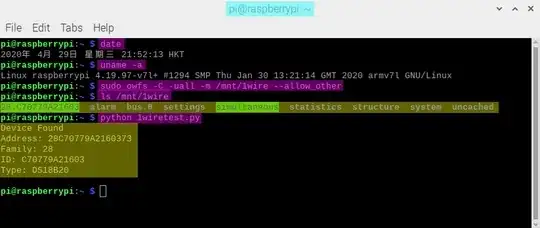

Part 3 - Detecting One DS18B20 Temperature Sensor
ds18b20 test

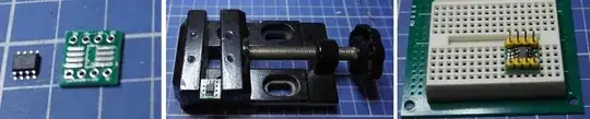

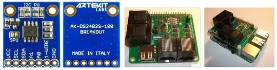

Part 4 - Soldering second DS2482-100 chip to breakout board for testing.
Soldering the chip to the breakout board took me 7 minutes. The pins are 0.05" apart. So it is not that difficult to complete the soldering task. My trick is the following: (1) Separately tin only one pin and one pad, (2) Put the chip on top of breakout board and use the soldering tip to melt the only one pin to pad, with a couple of trial and errors to precisely position the chip. The duPoint male connector pin soldering job are easy. Final multi-meter open short testing is also straighforward.
ds2482 soldering

Appendix C - DS2482-x00 Modules
ds2482 modules

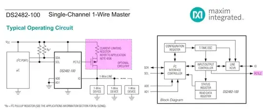

Appendix D - DS2482-100 Schematic and Block Diagram
ds2482-100 schematic and block diagram

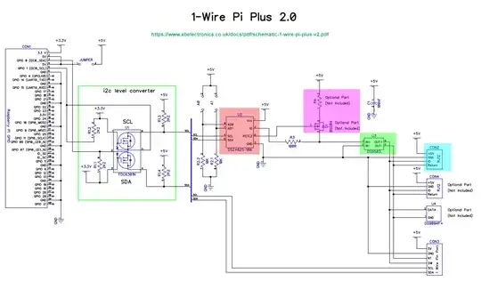

Appendix E - Enabling SPU (Strong Pull Up) of the DS2482 1-Wire Host Module
Application Note 3684 How to Use the DS2482 I2C 1-Wire Master - Maxim
How to enable DS2482 SPU - Ivan2 Artekit Product Comments 2018
The SPU pad is for the strong pull-up, to be used with the PCTLZ pin to control the on-board MOSFET. Both APU (active pull-up) and SPU (strong pull-up) must be activated using the internal registers. - Ivan2
App Note 3684 describes how to use the internal registers to (1) enalbe SKU, (2) change 1-Wire speed. One easy way to access the DS2482 registers is to use python I2C functions - tlfong01
Appendix F - Testing DS2482-100 using Linux kernel drivers
I googled and found a couple of kernel drivers for DS2482-100/800. I found the following Linux driver has the most comprehensive documentation, and therefore should be most friendly to newbies like me.
(26) Linux Kernel driver DS2482 for Maxim DS2482-100, Maxim DS2482-800
(27) Introduction to the 1-wire (w1) subsystem
(28) The Linux Kernel documentation 5.7.0-rc
Appendix G - DS2482-100 Schematic
ds2482
ab enc ds2482 schematic
