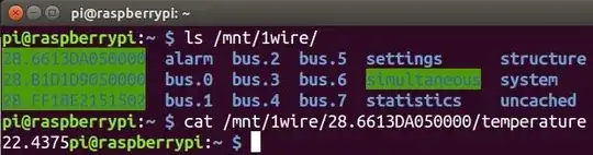

Following this tutorial I finally managed to start the owfs with:
sudo /opt/owfs/bin/owfs --i2c=ALL:ALL --allow_other /mnt/1wire/
and read out the temperature data like this:
Showing me the current temperature of 22.4375 °C.
