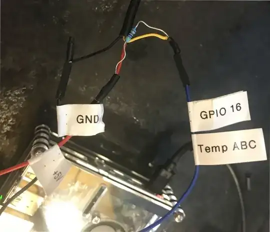

I'm having some trouble getting my nodejs program to find my DS18B20 temp sensor.
While the pi4's pins aren't shown this is the gist of the wiring. I have a 4.7K ohm jumper resistor between my yellow signal wire which connects to the blue GPIO16 wire and the red +5v wire. Maybe worth noting, I've also tried this using +3.3v
My wiring
See comments in image

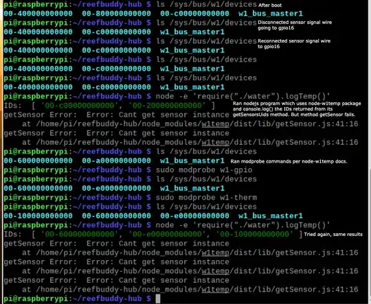

See the comments in the image below but basically a device seems to be getting added for the DS18B20 but the node-w1temp getSensor() method isn't finding it.
My checks
