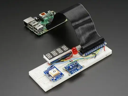

However, you may use as many as you wish. A good idea while developing something like this is to get a ribbon cable and expansion board built to export the pi's 40 pin breakout onto a breadboard.
(Courtesy Adafruit)
