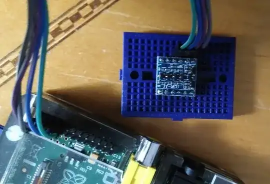

This means the signal voltage across the bus must be converted from one to the other. The most commonplace way to do that is probably a logic level shifter such as the one shown below.
This is on a small breadboard with a set of channels on two sides which the shifter spans. There is nothing connected on the other side (which there needs to be in order for the shifter to serve any purpose).
Shifters usually seem to support a small range of TTL voltages, of which 3.3 and 5 are very common. You attach a supply voltage corresponding to the logic level of the pi on one side and one of the device on the other. In the picture, this is the grey wire, which is on pin #1 (physical numbering -- there is no GPIO 1), supplying power from the 3.3V rail. If I were using a 5 V device which I was also powering with the pi, I would connect one of the 5V rail pins to the channel across from this on the shifter (or, if the device had a Vout, perhaps use that, or, if the whole thing is on a breadboard, use one channel connecting the shifter, the device, and the 5V supply pin).
The purple wire is ground and also requires a connection on the other side (unless there is already a common ground -- but some shifters may require a connection on both sides anyway). Beware that while the shifter may support a range of voltages, it is probably made such that the higher voltage is always on one particular side (in this picture the pi connection is on the lower voltage side; if you look closely/zoom in you'll notice an "L" and "H" on the shifter at one end on opposite sides). It is very important that this common ground be in place. The version on the other side must come from the device, or a ground rail which is common to the device (which may be from the pi, if you are powering it that way).
The blue and green wires are data lines on the UART TX and RX respectively (aka. GPIOs 14 and 15, which are physically the eighth and tenth pin depending on how you want to "count physically").2 This setup could be used to communicate directly with an Arduino, which is one alternative for controlling 5V devices indirectly. In that case, the 5V and ground on the opposite side must come from the Arduino.
Note that some logic level shifters use bi-directional channels and others do not; some may have a combination (a couple of bi-directional and a couple of uni-directional). "Bi-directional" means the signal may be flowing either way. For UART, this is unnecessary since serial buses use two channels to support duplex communication; one goes one way and one goes the other.

The shifter above has four bi-directional channels. There are various such devices around and they should be very inexpensive (I believe I got five of these for < $20). The two things to make sure of are:
  • The shifter supports 3.3 to 5V conversion (almost all of them will).
  • The shifter has at least one bi-directional channel, in case you need one at some point.
