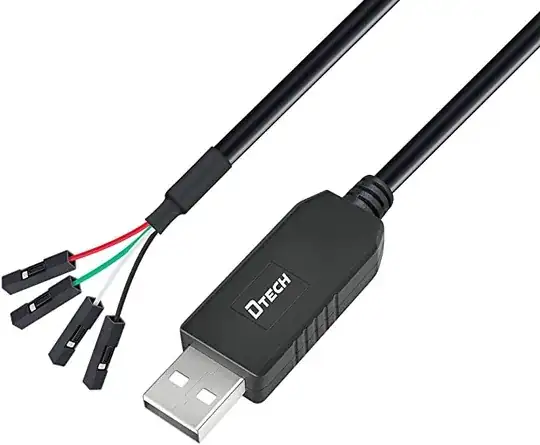

As for the RTL-SDR what I need is to plug it in to a second raspi USB port. The RTL-SDR driver is called rtl_433. In the meantime I will try to figure out what this driver needs other than just a "USB port". What I have is an adafruit "CONSOLE CABLE" with TX/RX/GND/5V jumpers on one end and USB-A-male on the other like the one pictured below. I am not sure what this exactly is but you can connect from a computer to the raspi when the console cable is connected to TX/RX/GND. The 5V connection would provide power downstream from computer to raspi and is meant to be used if the usb power plug on the raspi is disconnected. I am certainly confused.
What it looks like is that I stupidly assumed that since the "CONSOLE CABLE" has a USB-A-MALE plug it is the same thing as a usb port. I expect that it is not.
The raspi USB data plug (not the power plug) REALLY IS a usb port with a usb controller, so I should try putting the RTL-SDR on that instead and put the arduino on the console cable connected to (TX/RX/5V/GND). At this point, will this console cable enable me to do this and how?

You need a USB to serial cable. There are actually different forms of these as "serial bus" broadly can refer to various not directly compatible things, eg. USB to RS232 is "USB to serial" but it is not a normal UART port.
This is a USB to serial UART cable:
You would also need a logic level converter, since the Pi's UART logic level is 3.3V, not 5V.
But...
IMPORTANT! Do not take this to mean you could attach the four wires to the Pi's UART pins and use the other end as a USB port somehow -- you can't (not least because it is a male connector, by "somehow" I mean, don't try and shimmy something on there to make it female).

  • the RTL-SDR expects to be on a USB plug with a USB controller. we already have one usb data port on the raspi so it has to use that.
  • the console cable expects the jumper to be on the peripheral and the USB-A plug to be on the usb host. since the raspi is the host, and we can not use the console cable with jumpers on the arduino, the console cable is of no use.
