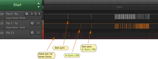

When you reset a Uno running the Optiboot loader, the bootloader first flashes pin 13 three times.
Pin 13 being flashed
Top line (gray) is sent to the Arduino, middle line (orange) is sent from the Arduino.
While that is happening, the program avrdude running on your computer is sending a query to the device:
STK_GET_SYNC / CRC_EOP  (0x30/0x20)
The Arduino doesn't notice the first "get sync" because it is busy flashing pin 13. Once it is done it notices the "get sync" (it would be buffered by the serial hardware) and replies:
STK_INSYNC / STK_OK (0x14/0x10)
It looks like avrdude got a bit impatient, and timed out, because it tries again with the "get sync" query. This time Optiboot responds immediately.

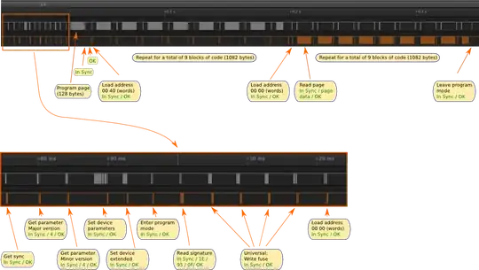

The rest of the uploading is described in the next image. Example produced uploading the stock "Blink" program.
Optiboot upload process
(Click on the image above for a larger version)
The steps are:
  • Query: Get Sync? Reply: In Sync.
  • Query: Get parameter? (major version) Reply: version 4.
  • Query: Get parameter? (minor version) Reply: version 4.
  • Set device parameters. The following device parameters are sent to the chip:
    0x42  // STK_SET_DEVICE
    0x86  // device code
    0x00  // revision
    0x00  // progtype: “0” – Both Parallel/High-voltage and Serial mode
    0x01  // parmode: “1” – Full parallel interface
    0x01  // polling: “1” – Polling may be used
    0x01  // selftimed: “1” – Self timed
    0x01  // lockbytes: Number of Lock bytes.
    0x03  // fusebytes: Number of Fuse bytes
    0xFF  // flashpollval1
    0xFF  // flashpollval2
    0xFF  // eeprompollval1
    0xFF  // eeprompollval2
    0x00  // pagesizehigh
    0x80  // pagesizelow
    0x04  // eepromsizehigh
    0x00  // eepromsizelow
    0x00  // flashsize4
    0x00  // flashsize3
    0x80  // flashsize2
    0x00  // flashsize1
    0x20  // Sync_CRC_EOP
    Optiboot ignores all those and replies with In Sync/OK. :)
  • Set extended device parameters:
    0x45  // STK_SET_DEVICE_EXT
    0x05  // commandsize: how many bytes follow
    0x04  // eeprompagesize: EEPROM page size in bytes.
    0xD7  // signalpagel:
    0xC2  // signalbs2:
    0x00  // ResetDisable: Defines whether a part has RSTDSBL Fuse
    Optiboot ignores all those as well and replies with In Sync/OK.
  • Enter program mode. Reply: In Sync/OK.
  • Read signature. Optiboot replies with 0x1E 0x95 0x0F without actually reading the signature.
  • Write fuses (four times). Optiboot does not write the fuse but just replies In Sync/OK.
  • Load address (initially 0x0000). The address is in words (ie. a word is two bytes). This sets the address for where the next page of data will be written.
  • Program page (up to 128 bytes are sent). Optiboot replies "In Sync" immediately. Then there is a pause of about 4 ms while it actually programs the page. Then it replies "OK".
  • Load address (now 0x0040). This is address 64 in decimal, ie. 128 bytes from the start of program memory.
  • Another page is written. This sequence continues until all the pages are written.
  • Load address (back to 0x0000). This is for verifying the write.
  • Read page (up to 128 bytes are read). This is for verifying. Note that even if the verify fails, the bad data has already been written to the chip.
  • Leave programming mode.
