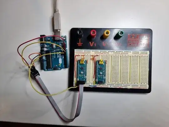

Should wind up looking something like this:

Just tried it now with the two Nanos in the photo, worked fine.
