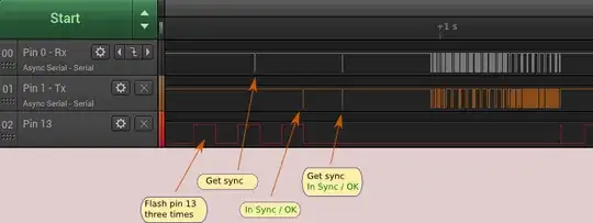

With Optiboot installed you expect to see three flashes:
Optiboot start
