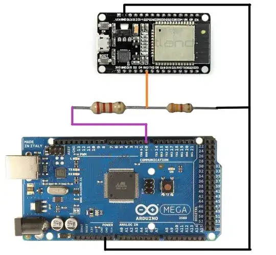

I'm trying to upload the sketch on a Mega 2560 via the serial port 0 using another microcontroller.
To better undestand the process, I decided to first observe what avrdude is doing while it is uploading a hex file. To do this, I'm using another arduino (ESP32) with the following sketch:

ESP32's Serial(serial0) is connected to PC via USB, and Serial2 is connected to Mega's Serial(serial0), the one connected to PC via USB, used by avrdude. enter image description here According to this answer the first things avrdude is sending over the serial interface are:

I can't find 30:20 anywhere. What am I missing?
The baud rate is 115200 everywhere which I believe is the right one. The link is good because if I send char 'A' from PC over the serial connected to Mega, I get 41: via ESP32 on the other side, which is correct.
