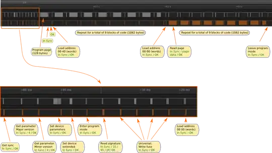

See What happens when code is uploaded using the bootloader?
There is a graphic on that page (reproduced below) which shows the general idea of what happens when you program using Tx/Rx after reset.
Optiboot programming
You could delve into the specs for the STK500 protocol (see linked page) and make your second Arduino follow that, to program from the SD card file.
