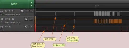

See What happens when code is uploaded using the bootloader? - the flashing is by design.
Optiboot flashing pin 13
Probably the reason is to confirm that the bootloader has started.

It's driven by the bootloader, which is performing the flashing (I suppose you are flashing through the USB port).

To show that the bootloader is functioning satisfactorily to the hobbyist. Boot loader helps to upload new sketch on the chip.
