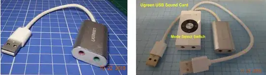

As above, I am using the same USB UGREEN "SOUNDCARD" as the RPi boards do not have a microphone jack or interface-- regardless of how you want to look at it.

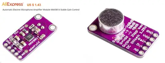

So I think at least you need some cheap voice input, like the US$2 microphone and power amplifier module below.
And another US$2 for an ADC chip, such as MCP3208 12 bit ADC.
So the ridiculously small budget of 5 dollars is good enough for your ridiculously small vocab voice recognition project.
Microphone module
Rpi USB Sound Card
