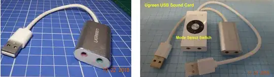

Well, a quick and dirty fix to your problem before the demonstration is the following:
  1. Forget the Rpi's poor quality audio amplifier circuit through the 3.5mm jack.
  2. Use an USB sound card for BOTH audio in (microphone), and audio out (loud sepeaker).
If you are in a hurry to google which USB sound card to use, you might like to read my suggestion in the following post.
Which USB sound card to choose - tlfong01's answer to an old question
usb sound card
