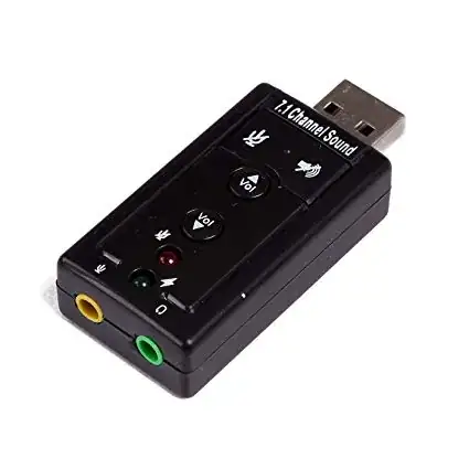

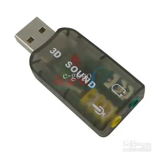

I'm using alsamixer and arecord, the problem is that when I'm recording it starts playing a weird whistle/whine/interference sound. it's like a beeeee and it doesn't matter even if there is not mic plugged in, it starts doing this sound. I have tried with a 7.1 channel sound card and a 3d sound card, but the result is the same. Any help is well received.
Pictures of my two sound cards:
USB sound card#1
USB sound card#2

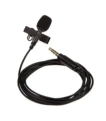

I'm using this mic:
Microphone
I have also tried using some headphones as mic but the same happens.

Try recording on a PC - if you have the same noise while recording, then the issue is with a faulty soundcard and not with the Pi. Considering the looks of that device, I wouldn't be surprised if it wasn't working properly.

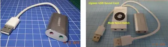

  2. Try another USB sound card. Don't use cheapy or fancy cards like 3D, 7.1. I recommend just simple mono or stereo.
Positive audio feedback usually centres around the high frequency end. If you don't need very HiFi, you can get a sound card such a uGreen which enables you to select low frequency mode, that can reduce positive feedback triggering.

ugreen sound card

Ugreen USB 2.0 Multimode External Sound Card US$12
Raw mode - HiFi Film mode - surround sound Music mode - low and high frequency compensated Game mode - low frequency boost
Cmedia CM6533 chip set (with 5 band equalizer and AGC)
Built-in 8051, 256K Byte flash, 32k RAM, GPIO pins, I2C/SPI/UART DAC/ADC 8 ~ 96kHz sampling rate, 16/24 bits resolution Equalizer to compensate microphone and headphone frequency response
