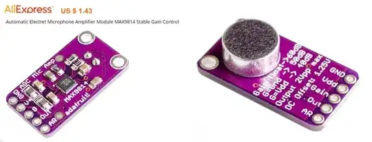

A sound sensor can be a very low HiFi quality sound detector. On the other hand many sound sensors are actually high HiFi quality Mike + Amp + AGC. I once played with cheapy (US$2) MAX9814 modules and found it good for hobbyists. But for better sound quality, see Note 2 below.
max 9814 mike amp agc
