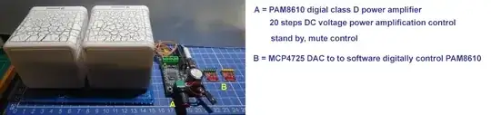

  1. Microphone - This part does not need much control. You just switch it on or off. Of course you can do mixing sound/music/voice by hardware using op amp, or use analog multiplexing and demultiplexing input/output audio channels.
  2. Amplifier - This part can be fiddled digitally, by Rpi python code. For example, I am using a digital, class D power amplifier, less than 10W stereo. with digital gain control (those you find in TV or HiFi equipment, press a button to let volume go up or down in say 20 steps.) You can also use a digital potentiometer (of course software control) to vary voltage which in turn controls the volume of the power amplifier.
All the hardware I have been playing are modules. So you are basically doing module/system integration, no IC, not to mention transistors.

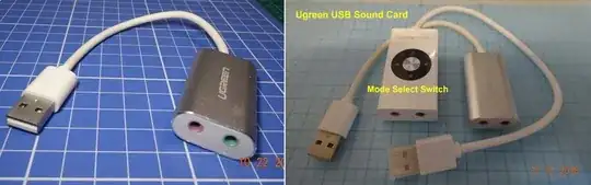

In case you have little idea where to start, I would suggest you to first get the following cheap things, and use linux audio libraries to play with them.
  1. USB audio cable to connect Rpi to microphones and speakers.
  2. Digital power amplifiers, say 2W.
rpi usb sound card
pam8610 power amp

USB Sound Card for Rpi - US$12
Digital power amplifier - US$2.30
PAM8610 10W Stero Class-D Audio Power Amplifier DC Volume Control
MCP4725 I2C DAC Breakout module US $0.82
