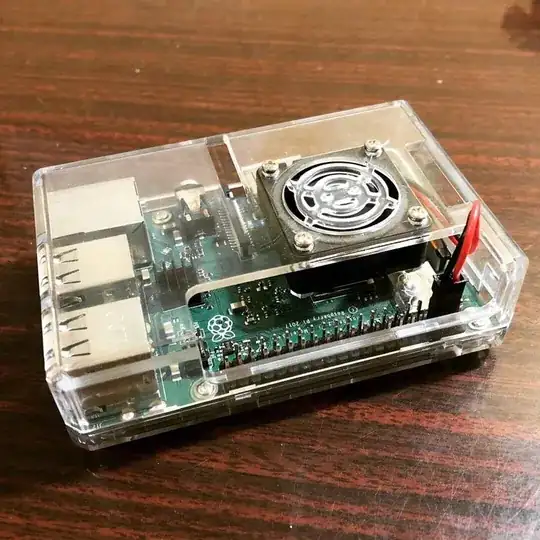

I have Raspberry Pi 3b+ with the case, which has a small 5v fan, which is connected to GPIO. Look to picture below:
The Fan runs continuously, but I don't want continuous operation. I want the fan to run only when the temperature of the Raspberry Pi exceeds 60degC. How can I do it?
How can I do it?

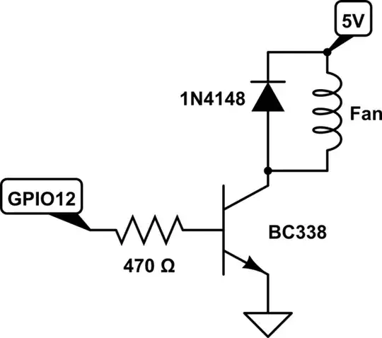

It is simple to control a small fan with the Pi GPIO.
I use a simple transistor circuit (with only 3 inexpensive components).
I use the Pi 5V pin to power my fan, but this could be used with an external 12V supply for 12V fans.
This is suitable for fans which draw up to 500mA. Substitution of a power transistor could be used to power larger fans.
schematic
The software is even simpler - only a single line needs to be added to config.txt
dtoverlay=gpio-fan,temp=60000
to switch the fan on at 60℃ - 60000 millicelcius (the default is 55℃ but you can select any temperature). The fan turns off when the temperature falls by 10℃.
This uses the gpio-fan overlay (which has been available in the kernel since late 2018) and should be included in recent versions of Raspbian. (Read /boot/overlays/README for description of this and other Device Tree overlays.)

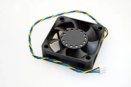

An alternative to making a DIY circuit is to get a fan with speed control input. These typically have 4 wires (color code may vary):
BLACK        - Ground
YELLOW/RED   - +VDC
GREEN/YELLOW - Speed output signal
BLUE         - PWM input signal
PWM signal can be used to set the speed using a PWM (typically with 20-80% duty cycle). Some fans will allow you to use it as an ON/OFF signal without any modulation, but some will switch off if the duty cycle is outside of their valid range.
The pin can be driven by your script/application or the gpio-fan overlay. You'll have to check whether a 3.3V signal directly from GPIO is acceptable (unlikely on a 12V fan, possible with 5V).
