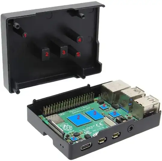

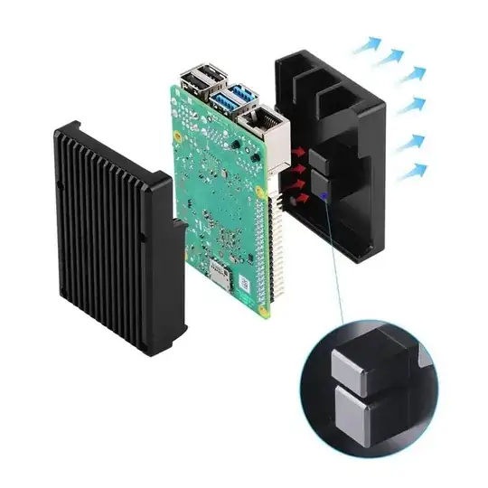

I use the "Geekworm Raspberry Pi 4 Aluminum Case" (Link) since a week with the 4GB model. This silent case cools all 5 chips passively (with itself as many other cases), not just 2, 3 or 4 chips as all other cases like this. Took some time to accidentally find it. Even if not all chips need cooling, better to be safe than sorry.
But I used Gelid's "Solutions GP-Ultimate Thermal Pad" with 1,5 mm height (15 W/mK @ 9 € for 120x20 mm, Link) and not the included thermal pads. I used no thermal paste, because I assume it might flow somewhere by external impacts etc. Pads are more safe, 15 W/mK is great for this price (thinking of the 17 W/mK 120x20x1,5 mm pads from Alpha Cooling for 130€ O.o), and they are easy to cut too. I have plenty left of the 120x20 mm pad after mounting all together.
After one week 24t/7h uninterrupted duty with Pi-Hole (my PC runs 24t/7h too + Smartphones, TV and PS4), it stays at ~43-44 °C (room temp. is about 25 °C). Directly after mounting all parts together and installing Pi-Hole, the temperature were at ~42 °C. This is good, but it might be not enough action to push the temperature higher. Later, I additionally use VPN on the same Pi for all traffic. Maybe more stuff.

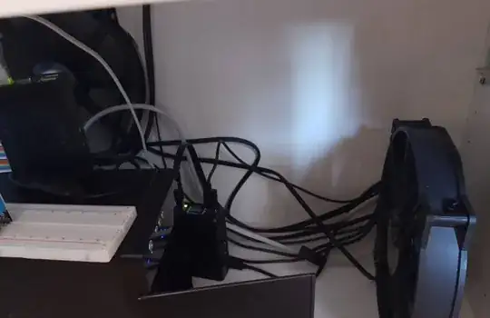

I can recommend metal passive cases for the pi4 combined with some airflow, I might overdone it a bit here with 2 big super slow vents but my 2 pi4s are usually running in the low 30c max 40 under heavy load. enter image description here

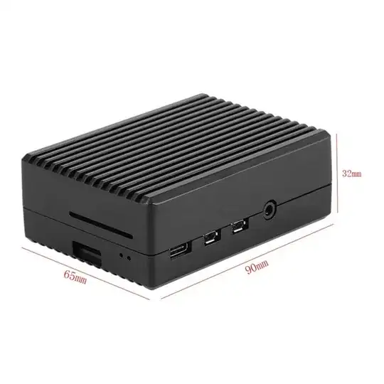

I have been running my Raspberry PI 4 full out 100% cpu usage on all 4 core for a month using mkp224o to crunch v3 onion addresses and my temperature hovers around 65 C, occasionally a few degrees lower or higher. The PI will throttle if it reaches 80 C, and I'm well below that. At idle speed it drops to 40 C. I am using passive cooling, no fan at all, and I am using the Geekworm passive cooling case (and the included basic thermal pads) from
https://www.amazon.com/Geekworm-Raspberry-Computer-Aluminum-Compatible/dp/B07VD568FB
