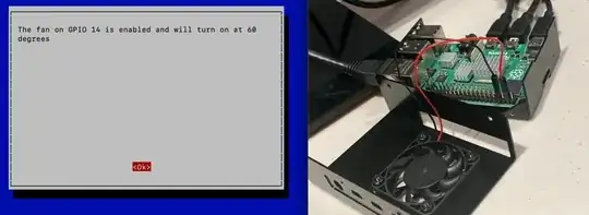

I have several Raspberry Pi 4 with a case that includes a fan. I connected the red cable to 5v Power(Physical/Board pin 4) and the black cable to GPIO 14 (Physical/Board pin 8). I setup raspi-config to turn on fan at 60 and use GPIO 14. When the temperature goes higher than 60 degrees, I notice the GPIO gets triggered, but the FAN doesn't spin. If I connect power and ground the fan spins. I would really prefer to make a config change and have to unmount and take apart 8 Raspberry Pi.
GPIO 14: level=1 fsel=1 func=OUTPUT pull=NONEenter image description here

When you use raspi-config to configure a GPIO to control a fan, you get the message "The fan on GPIO xx is enabled and will turn on at yy degrees".
That means, the GPIO will go high. So the fan would have to be connected to the GPIO with it's red wire, and the black wire would go to ground.
But, as one of the other answers says, the GPIO might not cope well with the inductive load. Also the GPIO going high will mean it will be at ca. 3.3V, which is not enough to make a 5V fan spin.
So what you need to do is add a circuit with resistor and transistor, as found elsewhere. E.g. see the circuit found in this (german language) tutorial.
