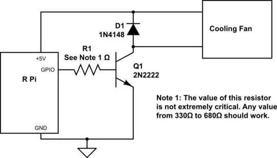

The components and interconnections required are shown in the following schematic:
schematic
Some notes re this schematic:
  1. You may use either the 5V supply (shown), or the 3.3V supply.
  2. The diode D1 (1N4148) is optional, but preferable, to limit "back EMF" when the fan is switched off.
  3. See this page for a "translation" between GPIO numbers and physical pin numbers
reboot and test
The dtoverlay will take effect after the next reboot. When the CPU temperature reaches 50℃, the designated GPIO will go "HIGH", thereby turning the transistor Q1 "ON", and causing the fan to start. When the temperature falls to approx 45℃, the fan will be switched "OFF" again.

Your Question is rather confused, but the following may help (if I understand what you are trying to ask).
You can not power a fan from GPIO pins. It is possible to power from 5V or 3.3V pins, but this will run all the time.
NOTE powering a 5V fan from 3.3V is not recommended.
Fan control is about the simplest workable solution. I use this on my Pi4 and the fan rarely operates, and only activates if it is stressed.
It is possible to control speed (over a limited range) using PWM. The hardware remains the same, you need to program the PWM duty cycle to control speed.
NOTE your question about different resistors is a bad idea. Operating a transistor in linear mode dissipates excessive heat; you would need to use trial and error to find a resistor which works (as Hfe of transistors varies) and motors are unreliable at low voltage.
