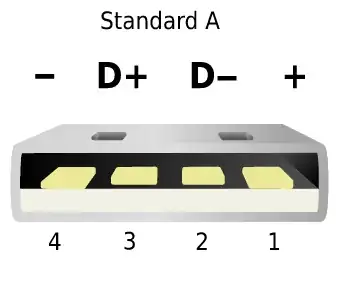

You need to connect the wires to pins 1 and 4 of a standard A connector. Which way round you connect the copper wires will determine in which direction the fan spins (or maybe it will spin in one direction, but not in the other, depending if reverse polarity is allowed, or blocked by an internal diode).
USB Standard A

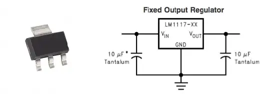

You would need to reduce the voltage from 5V to 3.3V by using a Voltage Regulator (such as a LM1117 or LT1086, plus many others), or a potential divider.
A linear regulator takes 5V, outputs 3.3V and expels the rest as heat.
Linear regulator
Source: Nut & Bolt
Using a regulator, you need to connect the regulator's Vin to USB pin 1, GND to USB pin 4. Then connect the regulator's Vout to one of the wires of the fan and the other wire to GND.

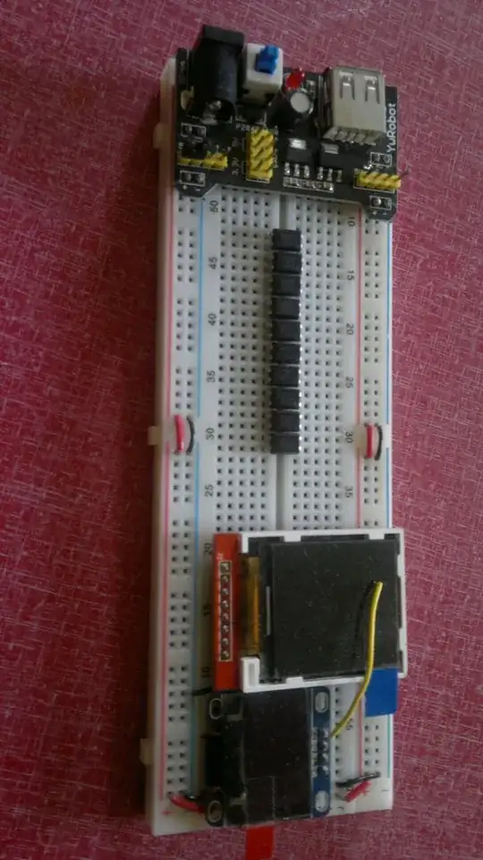

As you point out, you could use a breadboard, and a MB102 Power supply, as these have onboard regulators, and both 5V and 3.3V pins. Here is a photo of mine (ignore the optocouplers and the LCD displays):
Breadboard and MB102
If used in conjunction with a breadboard, that would be a perfect solution. They are reasonably priced. Then you can just poke the wires from the fans into the breadboard holes, and no soldering is required.

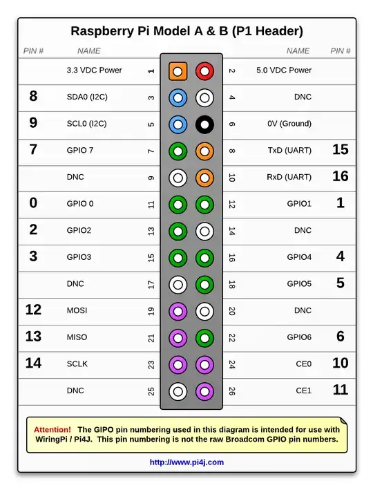

Using GPIO
Connect the bare copper wires to the 3.3V and the GND pins (Pins 1 and 6 respectively for both a RPi 1 and RPi 2).
Raspberry PI 1 GPIO Raspberry PI 2 GPIO

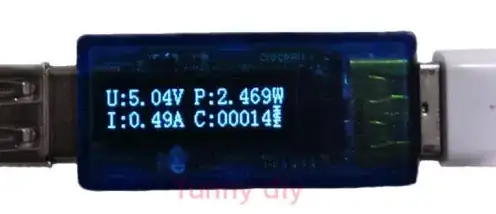

You can measure the current draw by using a USB voltmeter between the RPi and the fans. These are available on eBay for a couple of dollars.

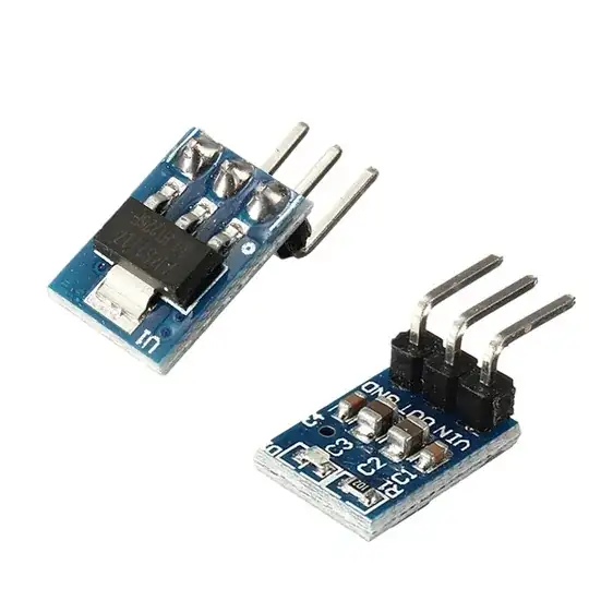

For a 3.3v Fan you can take power from Raspberry Pi USB port and convert the voltage to 3.3v using a small 3 pin VRM like this:
