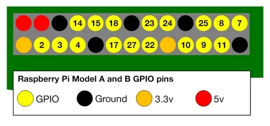

Regarding to the following picture, I understand that I can plug a 5 V fan by plugging it in between pins 1 and 2.
Is this right (+ on 1 and - on 2?)?
RPI B+ GPIO
My need: Plug a 5 V fan to run all the time the Raspberry Pi is on.

The diagram does not show pin numbers. Neither can I find anything on the diagram labelled 1.
The diagram does appear to correctly label the ground and 5V pins.
You can power a 5V fan by connecting its power leads to a 5V pin and a ground pin.
It will be on all the time as you can't switch the 5V pins on or off.
Do not try powering the fans from a gpio. The likely result will be one or more broken gpios and possibly a broken Pi.

This is right? (+ on 1 and - on 2?)

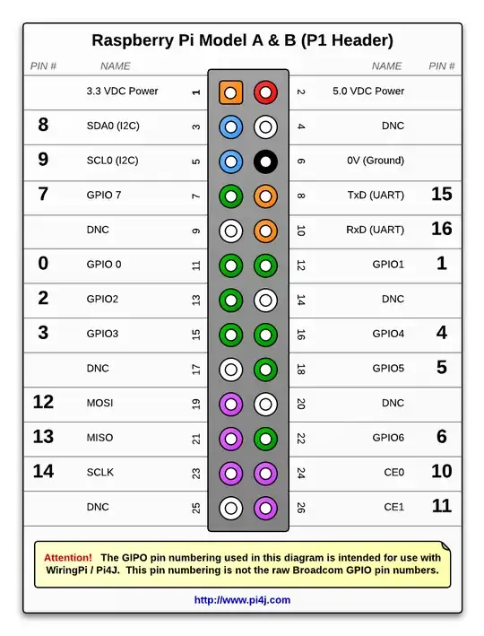

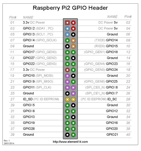

No, because you say that you have a 5V fan, and yet pin 1 is 3.3V, in addition to the fact that pin 2 on your diagram (which is in fact pin 3) is an I2C pin.
You should connect a 5V fan to the correct pin 2 (which is opposite pin 1 - the red pin in your diagram - not next to it) which is 5V and pin 6 (the black pin in your diagram) which is GND.
Raspberry Pi 1 GPIO

Raspberry Pi 2 GPIO
Raspberry Pi 2 GPIO
