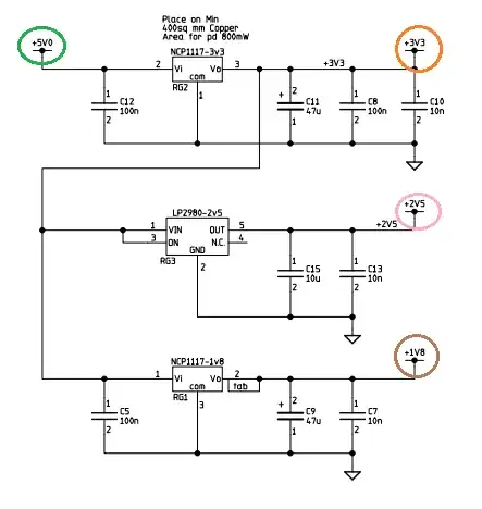

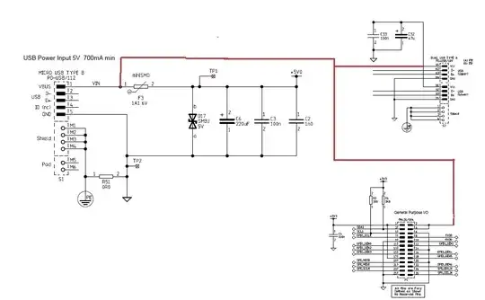

By the looks of the schematic the GPIO pins are connected to +5v Rail;

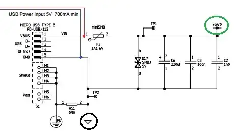

I have copied part of the input schematic on the USB power. In this sub section the +5v supplied from the USB connector is filtered to give a nice stable 5v supply to the 5V0 Rail.
By studying the schematic you come to realise there are 3 more voltages (4 in total) used on the Pi.
  • 5.0v; HDMI (self protected)(now I know why my active HDMI to VGA works OK)
  • 3.3v; BCM and LAN IC's
  • 2.5v; DAC
  • 1.8v; BCM(RAM) and LAN
This sub circuit which is connected to the 5V0 rail has 3 voltage regulators with their own filter capacitors.

To answer your question. Yes you can supply 5v on the GPIO pin. BUT, it has no backward protection and it was not really designed to be a 5volt input pin. the 3.3v pin can also be powered with 3.3v as the regulator has build in protection- but again it leaves your BCM unprotected! Typically any power pins on GPIO area are used to power extended circuits.
You need to realise that the USB schematic was carefully designed to be used as the primary +5V input and protects the Pi from getting fried. The GPIO pin does not offer this protection fully and you really need to trust your power supply if you want to do that!

  1. It is not ideal but you can connect +5v to the TP1 and GND to TP2 (TP = Test Point)

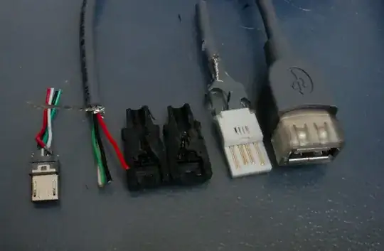

  2. Cut the micro USB cable and use the RED and BLACK colour coded cables and connect it to your power adapter. Using power adapters that are rate more than 1AMP (1000ma) is fine. The Raspberry Pi will not use more than 800ma any way- But the voltage HAS to be 5votls

First of all, using 5V GPIO pin you are bypassing input fuse that is on the RPi. This means you have no protection in case you make some short cut etc. So if you do, a lot of current (depending on how much you power supply can supply) can flow through your Pi and can damage it. You are also bypassing TVS diode so you are basically without any protection.
Also remember that you have to put regulated 5V to this pin. Most power adapters won't output regulated voltage (unless stated otherwise on them) so you would also need to use some voltage regulator circuit.
And last thing is that there is some smoothing capacitors that makes power more stable so it would be wise to connect some capacitors yourself.

If you look at the schematic, you can see that the 5V pin is connected directly to the 5V rail. :)
Connecting a barrel connector to the 5V and GND pins will be fine, but be wary you won't have the protection of the input fuse - such is life. Ensure you use a properly regulated 1A@5V PSU ideally with overcurrent protection; unregulated PSUs are useless!

Yes you can. If you use battery ,and not dc power supply is very safe as in my catspberry 2 progect.
the fuse f3 protect only nvcp11117-3v3 and some resistence near hdmi.
nvcp11117-3v3 Output Current Limit is typically 1A and max 1.5A and f3 fuse give max power of 1.1A.
Even if you use a dc power supply, connected to gpio, is very unlikely burn the nvcp1117-3v3 but you can use any kind of usb device.
If you use microusb power connector ,to give power to raspberry pi, you can not use many usb device because there is not enough power.
A good idea was make some modification to rasperry pi to give +5v directly from "microusb power connector" to usb and gpio ,without pass through 5v+ bus,like thise .
But for now the best thing is to feed the raspberry through the gpio, because if nvcp117-3v3 burns, buying it ,on ebay, cost less then 1€ expecially if you connect noting to hdmi connector and not have risk to burn his resistences

Simple Fix, Soldier to the side of the fuse that goes to the USB connector to your +5v in line, and your gnd to tp2 or the side of the capacitor that goes to gnd.
Then your still using the fuse. If it is more power you need, then your left with jumping the fuse.

(Edit by a no-points noob: The side of the fuse that goes to the USB connector is the side towards the edge. You can tell from the layout at http://www.raspberrypi.org/final-pcb-artwork/ -- The number 1 pin goes down through a via, under the center of the fuse, and then towards the edge.)

You can use the 4 NiMh batteries - but I would always check that the voltage is 5v or within .25v of that. Also I used a Nokia mobile phone USB connector connected to a USB socket from a broken, cheap hub (from a pounshop originally so only £1) with only the 2 outer lines soldered to wires going to the battery pack.
