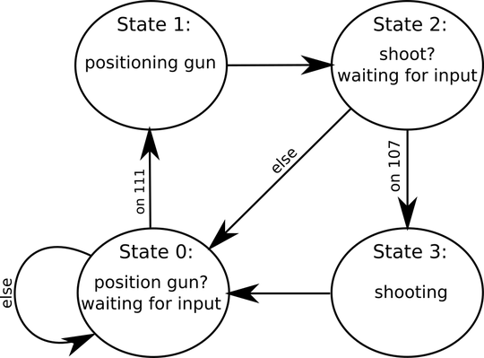

EDIT: For giving a better explanation about finite state machines, I've drawn a graphical representation of the states. Mostly it is way easier to code, when you first have drawn such a graph to visualize the codes functionality. Note, that this is the logic from your code. You may want it to work another way, but this is beyond the scope and only for understanding. Also note the different numbers of the states than I used above, which I only change, because I needed more states.
See first this graph:
We begin in state 0, where we are waiting for user input through serial. If we go some input, we make a decision: If the value is 111, we will transition to the next state (state 1) to position the gun, else we will wait again for more input. In stage 1, we are positioning the gun and go directly to state 2. There we are again waiting for user input. If we received something, we will again make a decision: On the value 107 we will do the transition to state 3 to shoot, else we will go to state 0, to ask again for positioning, like we did before. In state 3 we are shooting and directly go to state 0 again. This is rather strict division into states.
Since in state 1 and 3 we are only doing a short action and then going directly to another state, we might cut those states away, implementing the corresponding code in the transition from state 0 to 2 and vice versa. This is the logic from my FSM code example above (action together with transition). The graph would look like this:
Which version you should implement depends on other factors. If you are OK with the action code to be blocking, you can implement version 2, since it has less states. If you want to write the action in a non-blocking style, you might find version 1 easier to implement.
