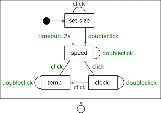

What you likely need is a state machine. The behavior of the actions depends on the state the program is currently in.
In your case, the state machine might look like this:
State machine
What does it mean?
  • black circle: this is where the system powers on
  • rectangle: a state
  • arrow: a transition from one state to another
  • green text: action
For the problematic double click action, you can see:
  • it changes the state from "set size" to "speed"
  • in all other cases, it does not change the state (actually it changes the state to the same state)
I always recommend drawing the state machine before implementing it. It makes mistakes much more obvious.
There are several ways to implement it. The easiest one being a switch/case. More advanced implementations may use object orientation. When using switch/case, I prefer to have one method per state, like so:
