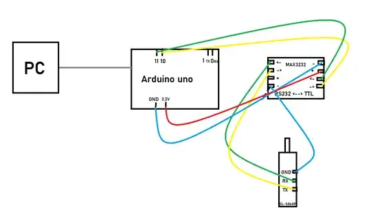

And the current schematic (sorry for my drawing skills)

You didn't show how you connected the MAX3232, so I cannot say anything about that. But I can write something about your code and how the data gets received on the PC.

Hi and welcome to the wonderful world of Arduino. It appears that you have picked-up Arduino with ease. Your program is almost there. Your wiring connection diagram looks to be correct.
