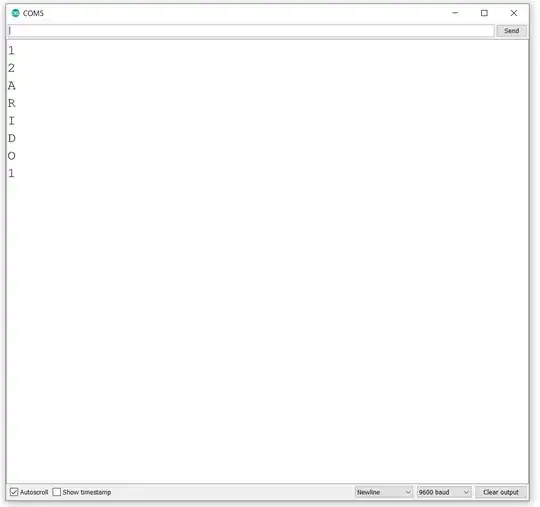

What’s puzzling me is, why can’t I get to assign the Serial.read(); value to my response variable (resp)? I’m going to try to explain this a bit further.
In my serial monitor I get the intended chars from the app buttons, however, my “resp” variable doesn’t seem to be getting any value from Serial.read(); for some reason, because when it gets to the switch statement, even though the char is printed on the monitor, the cases don’t start. For instance, and I might be completely off here, once I get ‘1’ on the monitor I should also start getting the distance measurement printed in the monitor and it’s not.
For what I gather, I believe the issue is between the Serial.write() and the Serial.println()/.read();, since the serial.write() seems to be taking priority over all others, since setting these lines as comments don’t affect the writing in the monitor:

Here is an image of what I get on my serial monitor. Serial Monitor with BT readings.

I guess the main problem is, that you write your commands from the bluetooth app, but the HC-05 module is connected to BTSerial. Here you are reading from it and forwarding the data to Serial (serial monitor on your PC):
if (BTSerial.available()){
    Serial.write(BTSerial.read());
    Serial.write('\n');
You are not doing anything else with the bluetooth serial data, so you cannot change the resp variable over bluetooth. Instead you are doing this with Serial (not BTSerial). But as long, as you don't type the commands into the serial monitor, that code will never run. Thus the distance code will never be executed.
If you want to control the program from the bluetoooth app, you need to actually work with the data from the right serial interface.
Btw: Your serial monitor is configured for a newline as line ending character. Your Serial code does not discard these, so you might get undesired behavior there, when resp becomes \n.
About your new problem: This problem actually existed also with the old code, but you couldn't see it, because the you were reading from the wrong serial interface. Try to read this (compressed) snipped of your (old) code:
