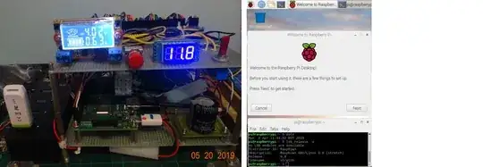

I suspected your PSU is marginal, and when booting, drops to a low voltage much below 5V, and so any weird thing can happen.
So I tried using a adjustable PSU and see if Rpi can boot at a voltage as low as 4V. My PSU is has a huge 10,000 uF (yes, 10,000 uF!) bypass capacitor, so there should be almost no glitches or blinking when booting. I also checked with my 3.5 digit DVM to make sure the voltage very near Rpi micro USD connector is almost the same as the PSU.
I surprising found that Rpi3B+ can boot a stretch 9.8 SD card at 4V (I think there should every little chance that your official PSU blinks below 3V3), though with yellow lightning warning and text message saying low voltage etc.
My conclusion is that my guess was wrong. Even if your PSU drops to as low as 4V, Rpi's on board LDO regulator can very forgivingly accept and boots to the end with the welcome screen!

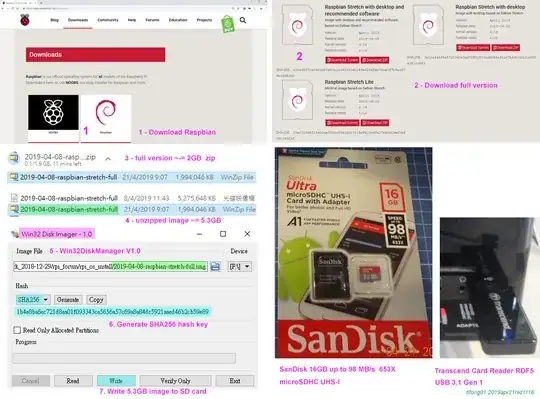

Update 2019mayhkt1425 - Recommendation to use 16GB cards
A couple of years ago, 4GB SD card was "fast", expensive but most cost effective, so I bought 4GB to install Rpi Debian then, which was 2GB.
But now it is not a good idea even to buy 8GB SD cards, because they are usually very slow, comparing with 16GB cards. So I have upgraded to 16GB which I think it is most cost effective now (2019).
And as Raspbian stretch 2019apr full version image is "only" 5GB, so I guess there is plenty of space for a hobbyist programmer like me. I have been doing Micky Mouse projects for a couple of years, and all the python programs added up to only a couple of hundred MB.
I am using Rpi3B+ and I think there is almost no speed difference if I have biggest or smallest version, if I used a 16GB SD card.
To summarize, I don't bother to consider which is the best size of SD card. I think 16GB card installing the biggest Raspbian stretch version is best for a hobbyist python programmer like me.
