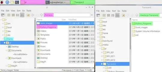

One important thing for newbies to know is that all their program and data files are stored in the default user directory "pi", which is under the home directory "home". This a a bit complicated, so let me show you a picture.
user files in rpi
The above rpi screen capture by scrot shows how I transfer all my user files from Rpi /home/pi folder to a USB flash drive (USB stick/finger).
I use the Rpi desktop file manager to go to /home/pi where are all user program and data files (in case you haven't intentionally placed your secret file outside the default file directory /home/pi.
For me I used to place all my program files in the directory Python_Programs. So I just drag and drop the whole directory's files from Rpi SD card image into my USB stick (named Transcend in this case). A couple of hundreds of MBs might take you more than 10 minutes, but then all you user files are now in the USB stick (or SD card in a copier, if you use a copier), which you can physically keep in a safe place, or go to your PC and read them as ordinary windows text/program/data files.
This way you don't need to use any bewbie scary and error prone linux terminal commands at the rpi side, and also no need to use Win32DiskMan at the PC side.

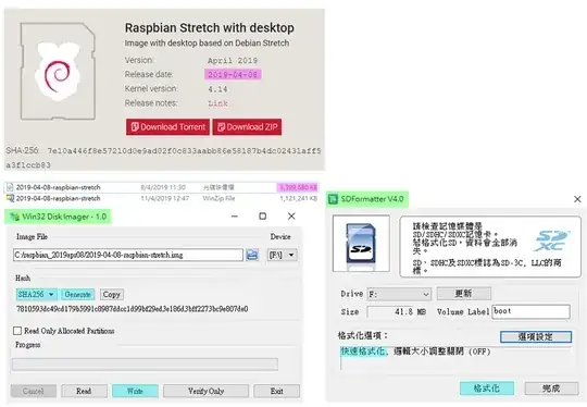

Let me show you as an example, the screen capture of my creating the stretch 2019apr version of SD card image for Rpi.
Win32DiskManagerV1.0
The above picture shows how to create the SD card image for stretch version 2019Apr (downloaded from Rpi's official download site).
I am using this picture as an example to show that you can read the SD card image copied using Rpi SD Card Copier, into a Windows file, named, say "myRpiImage.img".
You can then place this PC Windows Win32DiskMan compatible image file in a safe place, like a locked safe, physically in your home/office, or virtually in the cloud.
Moreover, you can use this read by SD Card Copier image as the master, to create more working copies, or backup copies, using Win32DiskManager.
The advantage of using DiskManager here to make more copies is that you can use SHA256 hash to verify the copies you make are very safe.
This way you can also pretend that you are no ordinary newbie, because you can duplicate Rpi SD card images with SHA256 security (not like other ordinary newbies do, using Rpi SD Card Copier).

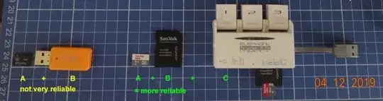

Use MicroSD Adaptor for the Micro SD Card for safer reading/writing and stupid human handling
I found using microSD copier not very reliable, because it has short and too close gold fingers which easily make poor electrical contacts (often you need to try a couple of times to make sure the very small card/writer is properly inserted). I usually use an SD card adapter to "expand" the Micro card to standard size big card, and the reading/coping is then more reliable.
Use SD Card Formatter to make a safer, more reliable copy
I often find micro SD cards intermittently fail to start, or making errors in the first couple of seconds. I usually use SDFormatter to format the SD card first. This way I found less intermittent failing starts.
