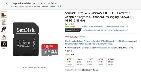

My SanDisk Ultra SD Card was purchased from Amazon exactly a year ago.
Before I purchase a pack of SD Cards, please recommend most reputed SD Card for Raspberry Pi
Here is the one I purchased a year back

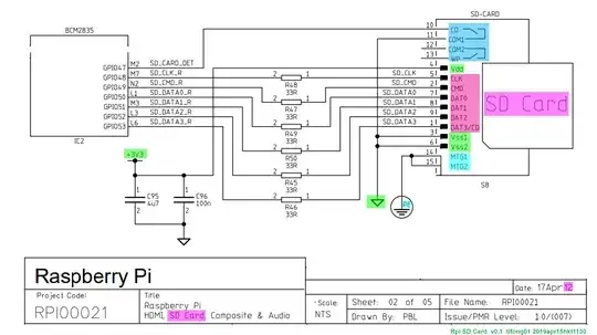

So I googled schematics, and found the following looking good. :)
rpi model b sd card

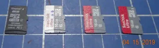

bad micro SD cards

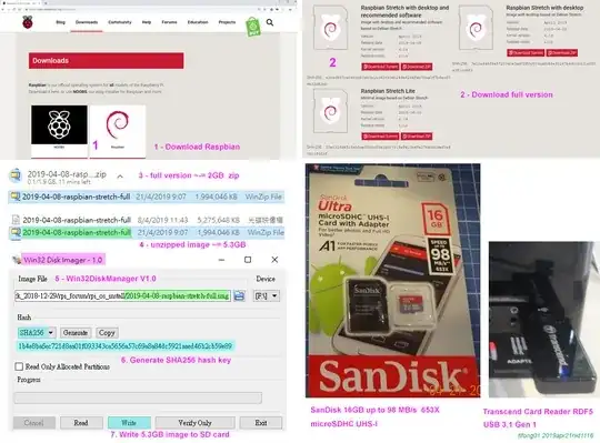

I copied the Raspbian 2019Apr image to four cards, as described by the picture below.
copying image causing heating up

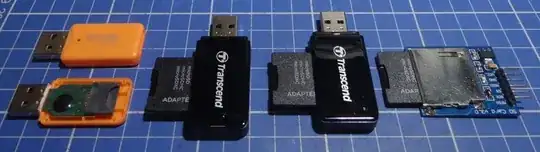

sd card adapter
