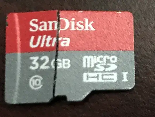

I also experienced an SD card overheat on my Raspberry Pi 3 model B. This is my 5th raspberry pi, and I have never experienced this before. All 5 raspberry pi's were the same build, using the same hardware.
The raspberry pi refused to boot. So I opened it up and saw that only the one red LED light was illuminated. I then noticed the SD card was very hot to the touch - too hot to keep my finger on it. When I pulled out the SD card, the card broke in half. Pieces of the hot SD card flaked off (you can see flakes missing near the top left corner in the photo - caused by the extreme heat). This was a new card, barely used. The entire device was new, purchased on Amazon. It all worked in the recent past!
Here is a reddit thread with several people reporting the same experience. Some say replacing the SD card solved the problem.
Update: Apparently an app I was developing was eating up lots of resources. It was pegging the CPU at 100% for a few days while I was gone. Perhaps the Raspberry Pi does not have a way to monitor SD card temp, and my runaway app induced the problem

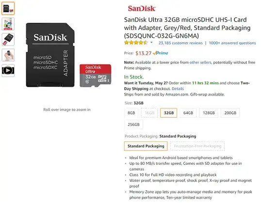

The source of the SD card was Amazon, and the Amazon seller was SanDisk. This is the link to the product I purchased: https://www.amazon.com/gp/product/B010Q57T02
Here is a screenshot of the Amazon page:
