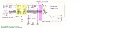

  2. If the "... trigger=heartbeat" statement is removed, or no such statement ever exists, but the green LED still faintly blinking, then the following is a possible reason:
    Something wrong with the hardware SD card detect line. The kernel therefore sends a "Send Status" command to the SD card once every 500ms or so. Getting a response means the card is still present. This activity is what is causing the faint blinking.
  3. So there is nothing serious to worry. It is just the SD detect line not working properly, and this causes kernel sending requests to SD card every half second, and SD card promptly responds, resulting the green LED blinking. The response is a very short pulse, therefore faint LED blinking. Everything except the SD detect line is working properly, and so this is not a serious thing to worry about.
  4. But if the boot process does not proceed further, I am afraid that there is not just the SD detect line out of order, the SD card might have other problems I don't know how to fix. :(. The last resort might be replacing the SD card reader, which is a SPI device and has only a couple of hardware wires interfacing. Or perhaps someone would google harder. :)
sd card interface
The pin-prick flash is the Pi trying to read the SD card. The Pi does this once or twice a second to see if an SD card is still inserted. It uses this method as the SD card present pin is not connected on the Pi. I presume this is used to detect if the SD card has been changed.
