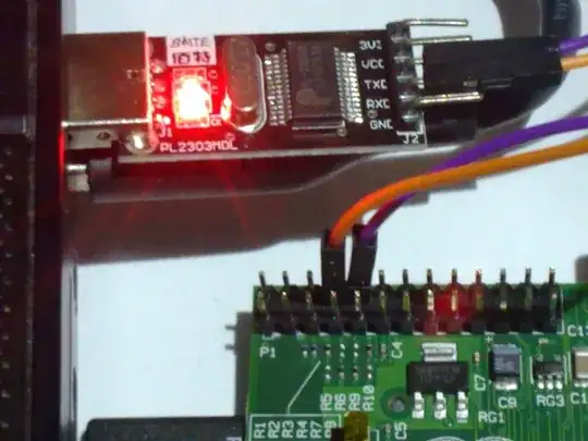

You can see bootup messages by connecting to the UART on pin 14/15 of the GPIO port
Here is how to connect it to one of the PL2303 UARTs that can be found on ebay for a few dollars.
I didn't need to connect GND because I am powering the RPi from a USB port on the same computer.
If you just want to see the boot messages, you'd only need the orange wire. If you want to log in once it boots, you'll need the purple wire too.
If you need to connect GND, it should go to the pin to the left of the orange wire.
PL2303 UART
Set the serial port to 115200 baud and you are all set
