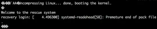

I think I spotted my first problem: I installed Raspbian and now at least I can see some text, but it contains some garbage.
A screenshot:
Any ideas on how to fix this? (I'm using the same config)
