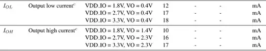

On the official Compute Module data sheet release 2 page 14:
IOL and IOH
The datasheet is applied to both CM1 and CM3, so as BCM2835 and BCM2837 when VDD_IO=3.3V. According to the table, It is safe to drive up to 18mA and sink up to 17mA by GPIO.
