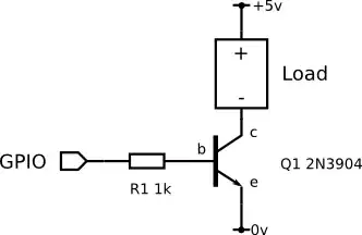

But don't worry, it is possible to connect your fan. Just use NPN transistor like 2N3904, connecting it's base to your GPIO pin through 1Kohm resistor. It's well documented here: http://elinux.org/RPi_GPIO_Interface_Circuits#Using_an_NPN_transistor along with many alternative designs, so I highly recommend visiting this site.
I took a sample NPN circuit from there:
You just connect your fan instead of load and use one of the 5V pins (not the GPIO!). Keep in mind that your power supply should be capable of delivering enough energy to keep both Pi and your fan powered at the same time, so don't connect electric heater there ;)
