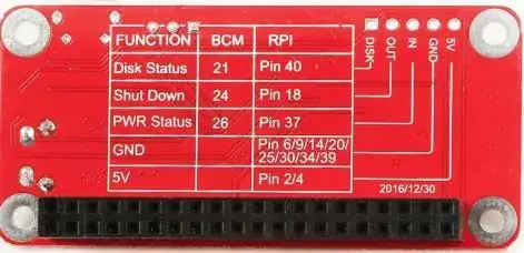

new to all this but great fun. I have a raspberry pi3 and i did have a fan connected to it. I just added a power supply battery. i also added a IR remote and power button which sits onto of the gpio pins. So now I have no Pins that i can plug my fan into. what does everyone else do?
thanks
This is the uri of it as away from desk https://www.robotshop.com/media/catalog/product/cache/image/240x240/9df78eab33525d08d6e5fb8d27136e95/i/r/ir-remote-power-module-raspberry-pi_1.jpg
The hat you are using is not taking all GPIO ports, see bottom of the board: IR and remote button
Use of any of remaining GPIOs. Soldering would be required.

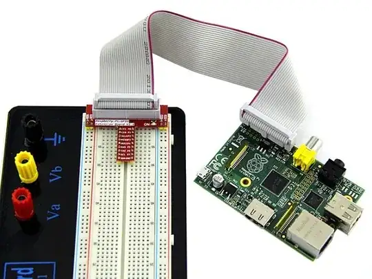

If soldering brings too much hassle, you can try breadboard and Raspberry Pi GPIO to breadboard interface. Picture from below show seedstudio's kit. RPi GPIO to breadboard
Amazon sells similar item under name of 'Raspberry Pi GPIO Breakout Board Bundle', or something like 'T Type GPIO Breakout board for Raspberry Pi' It gives you basic set with jumper leads to connect whatever you need.
When you proof your set is working, you can try to mount it on protoboard (soldering required!).
