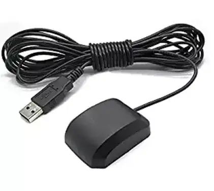

Here is the receiver, a G-Mouse USB GPS unit.

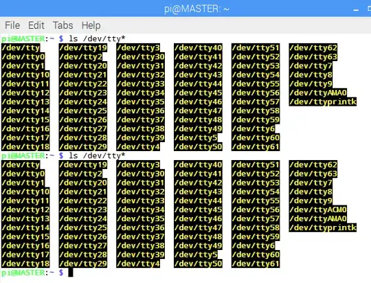

First thing is to find the tty port it uses.
Start by opening a terminal window. Look at the devices, then plug in the GPS unit and look again:
I can see the new entry is /dev/ttyACM0

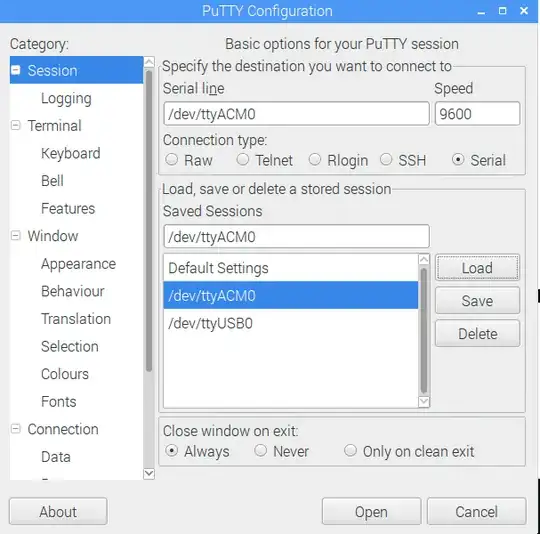

So I open PuTTY, which I previously installed by
sudo aptitude install putty
Click on the Serial connection type, and enter /dev/ACM0 in both places as shown here:
(image)

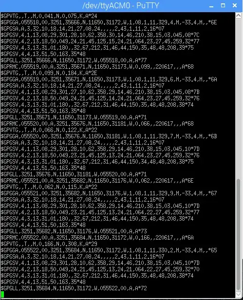

Click on connect (Mine was saved so it says Open) and I get this output:
(image)
Now I know it is connected and that it works, and is receiving data at 9600 baud. (This is an issue, however, since the NMEA standard very specifically says 4800 baud is expected.)
I even know the data is in the NMEA format, described here:

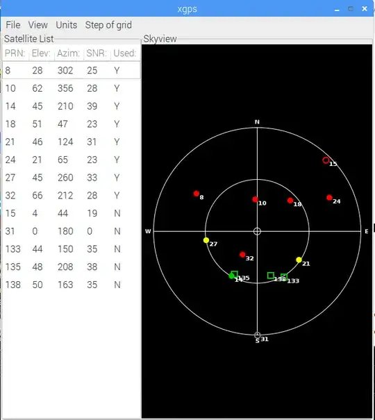

There is also an X-11 version that looks much better, and is run by this command:
xgps
It looks like this:
(image)
Mine shows 13 satellites, and it is using 8 of them. The red ones are GLONASS.

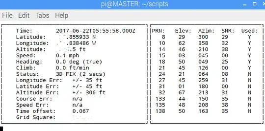

If you want to run xgps remotely from another Linux machine, use these two commands together:
ssh -Y pi@MASTER
xgps
The -Y is there to allow SSH to carry the X-11 output over ssh.
Personally, I prefer the output of
ssh pi@MASTER
cgps -s
