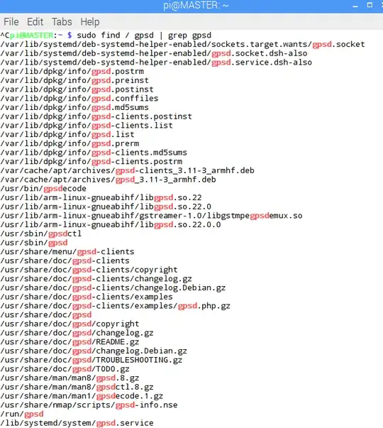

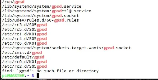

You can find all the files by using this command:
sudo find / gpsd | grep gpsd
Here are the results on my system: enter image description here
