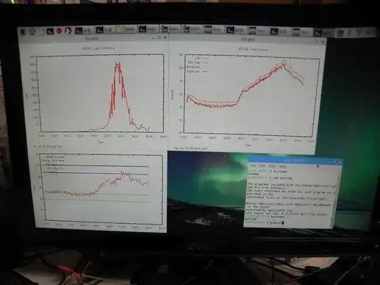

Here is the sequence to get three live plots from the same system:
Open terminal window
ssh -Y OUTSIDE
gnuplot
load "plt4    <--loads the data showing 4 temperature sensors
ssh -Y OUTSIDE
gnuplot
load "pl12
ssh -Y OUTSIDE
gnuplot
load "plux
Once the plots are running I resize the terminal windows and arrange them on the screen.
For good measure I do another terminal showing the ssh sequence.
Voila, here I have four independent sessions into the OUTSIDE system with three of them displaying live plots and the fourth one to show hostname before and after the ssh command:
That is the answer.
