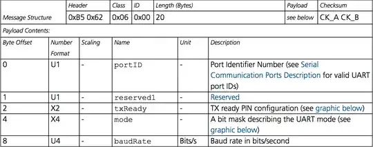

I can change GPS configuration by sending hexadecimal data to GPS, like this:
Message structure from m8n documentation
I have the GPS module connected to UART pins in the Raspberry Pi.
  1. First problem
How can I do this in python? How can I "build" hexadecimal messages in Python and how can I send them to GPS module?
