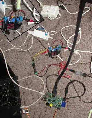

Testing environment (big version)
Voltage is generated by this device and measured by this meter.
I started Raspberry Pi with Ethernet and HDMI connected, with usual Raspbian "2014-06-20-wheezy-raspbian.zip" on SD-card. Nothing is connected to USB ports.
Usual mode
I started from 5.15V and decreased the voltage gradually, checking how the device is working (using UART to starts things there).

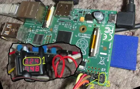

Special mode: bypassing linear regulator
Images of Raspberry Pi with shorted pins and voltage display
  1. Ensure the input voltage is less than 3.5V, not 5V;
  2. Ensure no other input 5V voltage sources are present;
  3. Short conveniently placed 5V pin and 3.3V pins together.
I started with 3.39V and checked what works and what fails as I decrease the voltage:
3.39V 0.45A
    Works like usual, although if you want USB you'll
    need lucky undervolting-friendly devices (or probably a powered hub).
3.39V 0.54A (yes > /dev/null)
3.39V 0.50A (cat /dev/mmcblk0 > /dev/null)
3.25V 0.45A
3.10V 0.45A
3.10V 0.39A (no eth)
2.95V 0.44A
    Probably near the lowest voltage where USB and LAN may still work.
2.85V 0.22A "Disabling IRQ #32"
    LAN goes down.
2.75V 0.22A (no eth)
    Unstable operation.
2.75V 0.31A (no eth; cat /dev/urandom > qqq;)
    Loading CPU: still works...
2.75V 0.18A (short bootloop)
    Writing to SD card (typing "sync" command): reboots and
    even can't load the Linux kernel back.
2.80V 0.2 A (long bootloop)
    Still can't boot, probably rebooting instead of initializing USB.
2.79V 0.22A (no eth)
    Decreasing voltage after the boot has finished.
2.79V 0.18A (no eth; no HDMI)
    HDMI is turned off explicitly by tvservice -o
2.79V 0.29A (no eth; no HDMI; yes > /dev/null)
2.72V 0.18A (no eth; no HDMI)
    Gradually decreased voltage to this after fully booting.
    Short bootloop on attempt to load CPU with "yes > /dev/null".
2.66V 0.16A (lowest voltage to receive "Uncompressing Linux...")
2.64V 0.10A (no messages to UART, but it attempts to start)
2.56V 0.06A (no messages to UART)
Note that protection fuse is also bypassed in this mode, so the risk of rendering the board nonfunctional is higher in this setup.
