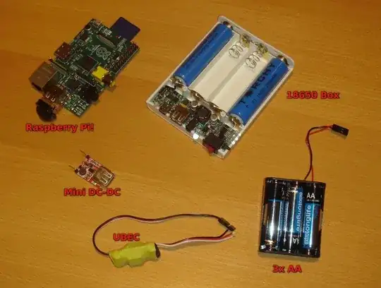

Using an RC-model UBEC
Decent radio-controlled models, especially aircraft, often need an efficient, stable-voltage power supply running from a small, light battery. The standard approach for this is to use a rechargeable battery linked through a device known as a UBEC (Ultimate Battery Eliminator Circuit), which takes a higher voltage than the required output, and very efficiently down-converts it. Whereas a linear regulator feeding 500mA output from a 6V input would draw 500mA (leading to wasted power of (6-5)x0.5 = 0.5W), a UBEC will not need to draw the full 500mA from the input battery, and so wastes very little power.
Because UBECs are so commonly used for RC models, you can pick them up very cheaply, and they can generally handle some pretty high currents. For instance, I found a 4A model on eBay for about £1.50 including postage.
The drawback is that you need to supply more input voltage than the desired output voltage, which means you may need a lot of cells in the battery pack. Still, this is a very cheap option and works well.
Using a DC-DC converter
If weight is a priority, then keeping the number of battery cells to a minimum is important. Fortunately, there's a device called a DC-DC converter that works in a very similar way to a UBEC, but can work from an input voltage that's lower than the required output voltage. These are also typically really tiny.
Looking on eBay again, I found some really nice ones, which include a female USB-A socket. This means that you can use the same USB lead that you're probably using to power your Raspberry Pi, without any modifications. The price here was around £2.50, with free postage. Input voltage is 3-5V (ideal for 3x rechargeable AA), and output current is up to 1A, which should be plenty.
Using an integrated battery box
Finally, there are various solutions available which use rechargeable batteries plus a DC-DC converter, in a dedicated housing. These can be pretty nice, because they don't require any specialist assembly (e.g. soldering) - some even have the batteries already built in. The option I chose uses high capacity "18650" Lithium Ion cells (e.g. these, around £10 for a pair from eBay), and cost around £8 including postage. It can supply up to 2.5A, which is more than enough, and again has a built-in USB-B socket for easy connection, as well as a convenient USB-miniA socket for easy charging. Another nice feature of this type of box is that you can stick in anything from 1-4 cells, depending on how much battery life you need.
A drawback is that these boxes can be quite large. The one I chose is about the same size as the box that my Pi came in from Farnell.
If you do go for the 18650 option, then it's worth shopping around carefully. Some brands, most notably Ultrafire, have a poor reputation for quality and don't seem to live up to their rated capacities. These types of batteries are also prone to fire or explosion if used improperly - so you'll want to be very careful to look after them, and it's worth making sure that you're not using a dodgy brand.

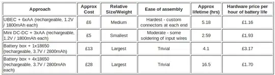

When calculating theoretical battery life, because you're converting voltages, you can't go simply by the milliamp-hour (mAh) ratings printed on the battery. It's simplest to convert to watt-hours, which is simply voltage multiplied by the mAh figure. The RasPi needs approx 500mA at 5V, which is 0.5 x 5 = 2.5 watts. Assuming perfect efficiency in the converter (they're usually at least 90% efficient), a 1.5V AA cell with 1000mAh capacity would be able to supply 1.5Wh - i.e. run a RasPi for approx 1.5 / 2.5 = 0.6 hours (or 36 mins) on its own. With a switched-mode converter (i.e. any of the last 3 options), it doesn't really matter whether you connect multiple cells in series or in parallel - in each case, you're roughly multiplying the available capacity by the number of cells used.
Here's an easy side-by-side comparison of the options listed above. I hope it helps you to figure out an appropriate battery power solution for your Pi project.
Battery Comparison table
