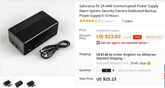

Will it be possible to provide short term power to the B2+ model with the following setup?
5V 2A 44W Uninterrupted Power Supply Alarm System Security Camera Dedicated Backup Power Supply 6-10 Hours
and

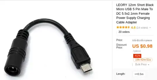

Micro USB 5 Pin Male To DC 5.5x2.1mm Female Power Supply Charging Cable Adapter
Will the micro-USB power adapter work for the pi?
Update
I ended up getting a slightly different model which is directly pluggable into the socket, includes the rechargeable battery. Everything works fine in combination with the listed coaxial to micro-USB adaptor.
Yet, the question was not about specific products, it was more about a certain class of configuration, so the technical wording of the question would be Is it possible to power the PI with a mini UPS which is not built specifically for the PI and has a different power plug. Searching for mini UPS was what led me on the right track.
The answer is yes, it works with the given combination, and in unplugged state I get roughly 90 minutes of continuous MP3 playback with a connected 32GB USB flash stick.

There are several considerations for choosing UPS supplies for the RPi.
Surprisingly, one of those is safety. The RPi is small, portable and frequently used outdoors in areas subject to wet contact. National electrical codes (e.g., US NEC) often restrict voltages subject to wet contact. This means that using an indoor UPS to power your RPi would "work" but not be safe if the UPS was outdoors (e.g., in the rain).
Another important consideration is the output voltage of the UPS. Since an RPi in the field can be some distance from a line voltage power supply, the length of the wiring between the Pi and the UPS matters significantly. Although a 5V UPS can nominally power an RPi, it will fail to do so over long thin wires outdoors because the wire resistance will cause a voltage drop below the 5V required by the Pi.
For uninterruptable indoor power supply, your options are many given the ready availability of line voltage. Do be safe and consider electrical code (e.g., putting a UPS next to the bathroom sink for your RPi smart mirror would be shockingly bad). Although UPS products are available and marketed as such, you may find the convenience of rechargeable batteries more compelling (e.g., 12V lithium battery with USB outputs) if portability is important.
For uninterruptable outdoor power supply, consider using batteries (e.g. 12V LiPO with USB output) and wiring that comply with national electrical codes. Not all rechargeable batteries support simultaneous charge/discharge. Consult SE Electronics for more information.
