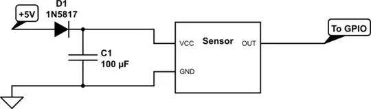

If heat is not the root cause and you're convinced the issue is power-related (can be easily confirmed by using a separate power supply for the sensor), using a decoupling capacitor is a natural starting point. Such a cap should always be placed on the power line. Adding a low-pass filter on the signal line would interfere with normal operation and may even be forbidden by the datasheet, as many devices become unstable if they have to drive a large capacitive load. Another idea is to add a Schottky diode before the cap, so it is not drained by the CPU during load spikes:
schematic

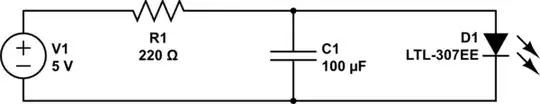

I have the same problem as OP, using a Raspberry Pi model B and a RPM6938 IR sensor. My circuit setup is similar, and I observed the same behavior: as the CPU load goes up, the data pin arbitrarily goes low. This also happens when the CPU is idle, although at a lower rate.
I think we can rule out the chip heat as the source of the interference, since the sensor reacts to IR modulation. And the problem goes away if I use an independent 5V source for the circuit.
I tried placing a capacitor in parallel to the sensor's power and ground lines, and this has fixed the issue - no interference at all no matter the CPU load, the pin only goes down when I point an IR remote at the sensor. I have represented the sensor as a LED in the schematics below:
schematic
My understanding of circuits is too limited for me to explain why this yields the expected behavior, though.
