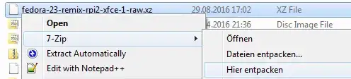

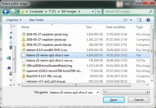

Fedberry is worth having a look at. It is based on Fedora 23. They provide images as download. The large one (~720 MB download) extracts to a 4.6 GB disk image including XFCE.
On Windows, I was able to uncompress the unusual .xz extension with the help of 7Zip. I then wrote it to the SD card using Win32DiskImager as I would do for Raspbian. Since the extracted file does not have the required .img extension, you have to enter * in the file open dialog to find it.
Like Raspbian it will resize the disk at first boot and ask for configuration when booted.
