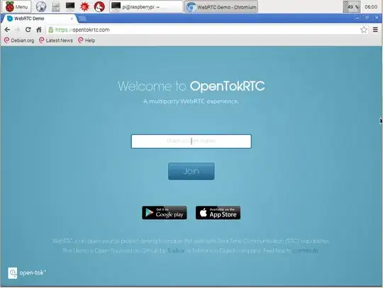

Hmm... Maybe not. Version listed is 22.0.1229.94
EDIT: Image below of Chrome at opentokrtc.com
Does this mean it works?
EDIT: EDIT: After adding a room it doesn't appear to be responding correctly. However, I wasn't able to get it to respond in a way that I thought with Chrome version 40.0.2214.115 on my desktop. I'm afraid that the jury is out for me. Chromium will install, but the version looks to be too early. I was not able to confirm operation.
