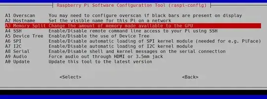

Just run sudo raspi-config, then go to Advanced Options then Memory Split:
Raspi-Config Shot
